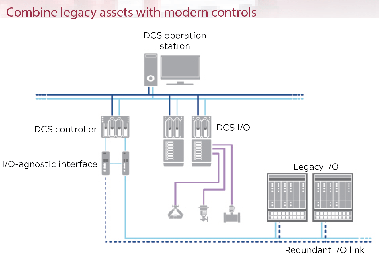

To further simplify I/O without overhauling the plant’s entire infrastructure, many modernization teams are turning to I/O-agnostic interfaces to lower capital costs and speed conversion. An I/O-agnostic interface is installed between new controllers and legacy I/O. With the interface in place, modernization teams can install the control system of their choice, while leaving legacy I/O wiring, terminations, and infrastructure in place.
Once the new control system is installed, the team can immediately begin reaping the benefits of modern control best practices, such as better human-machine interfaces, alarm management, and easier integration of wireless sensing technologies. The DCS and legacy PLCs are no longer a roadblock to efficient, effective data transfer.
