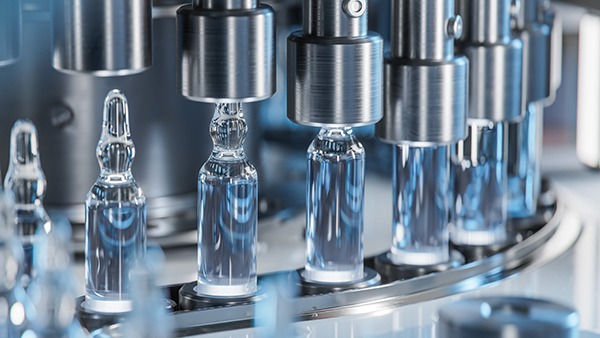

High-precision processes, such as those used in pharmaceutical manufacturing, benefit greatly from the ability of smart instrumentation to minimize downtime.
Smart instrumentation, with diagnostics and verification capabilities, advances uptime and safety in process systems.

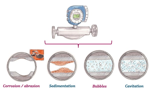

Figure 1: Left unmaintained, plant performance can degrade over time due to accumulating process conditions and measurement drift. Courtesy Endress+Hauser
Manual maintenance drawbacks
Every plant process has critical measurement points that must be accurate to ensure proper functionality. However, instruments used to make these measurements can drift or detrimental process conditions can develop, such as corrosion or debris buildup (Fig. 1), reducing accuracy over time.

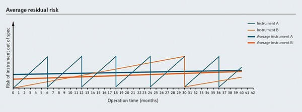

Figure 2: Two instruments, A and B, are operated for 40 months. Instrument A must be manually calibrated every six months to limit risk to acceptable levels. Instrument B performs automated verification every two months, so risk increases more slowly. Manual calibration must be performed only once every 30 months to remain within acceptable levels. Courtesy Endress+Hauser
Without automated diagnostics, minor errors can go undetected, resulting in quality and safety reductions (Fig. 2). The predictive-maintenance monitoring techniques described above make it possible to identify issues sooner, more reliably, and at lower cost, than with manual inspections.
By leveraging automated verification and diagnostics, plant personnel can significantly increase manual maintenance intervals while benefitting from greater productivity and safety, with a lower risk of undetected instrumentation or process issues.
