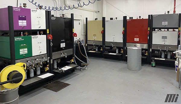

This is an example of a clean and organized lubrication storage room. Investing in larger, color-coded storage tanks for each lubrication type is a good way to ensure fluid cleanliness. Image courtesy Motion

Store lubrication properly.
Too often, there is little investment in a well-organized lubrication-storage system. It’s too easy to use your lubrication supplier’s oil or grease drums as the primary storage device. Beware of this trap. Storage drums are typically not clean enough to meet ISO codes. It’s also challenging to control moisture buildup in multiple drums in a storage room.
Invest in larger storage tanks for each lubrication type. Pump lube into them from a drum using a micro-glass filter. For each storage tank, have a dispensing system that uses filters to further control oil cleanliness and desiccant breathers to control moisture buildup in the tank’s headspace.
Using grease pumps in bulk storage drums and pre-filled grease tubes significantly reduces grease contamination when handling or dispensing.
Choose color-coded supplies.
Color-coding storage tanks and hand-dispensing jugs minimizes cross-contamination of lubrication products. The visual system can also be used for drum storage and dispensing devices. Colored tags are readily available in many shapes and sizes that accept stamps or writing.
