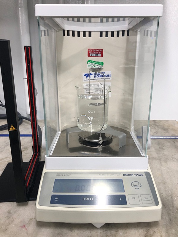

This balance, fitted with a density-determination kit, is part of a simple test to determine lubricant compatibility with elastomer O-rings.

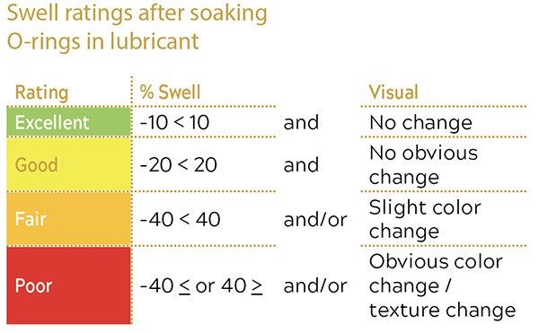

A simplified test can be conducted to evaluate compatibility where a lubricant is evaluated against an elastomer O-ring. This method involves soaking O-rings of various materials, such as buna-nitrile, EPDM, silicone, and PTFE, in the lubricant of choice in an oven set at 125 C for three days. The dry and wet mass of each O-ring before and after exposure is measured using an analytical balance fitted with a density determination kit. The method calculates the volume swell (ΔV%) by using the initial mass and the mass after exposure. A visual inspection is also performed to assess compatibility. This test method determines compatibility between a lubricant and elastomer under exposure conditions. The swell between O-rings may or may not be easily seen while, in some cases, it can be significant.
Use this table to evaluate change in EPDM O-rings after soaking in a lubricant.
While testing is an important step in understanding material compatibility, it’s not the only consideration. Compatibility is also dependent on the specific application of the materials. Swelling can be beneficial for some applications, such as sealing an interface. In others, it can cause components not to fit together as intended. It is important to understand how any observation will affect the specific application.
