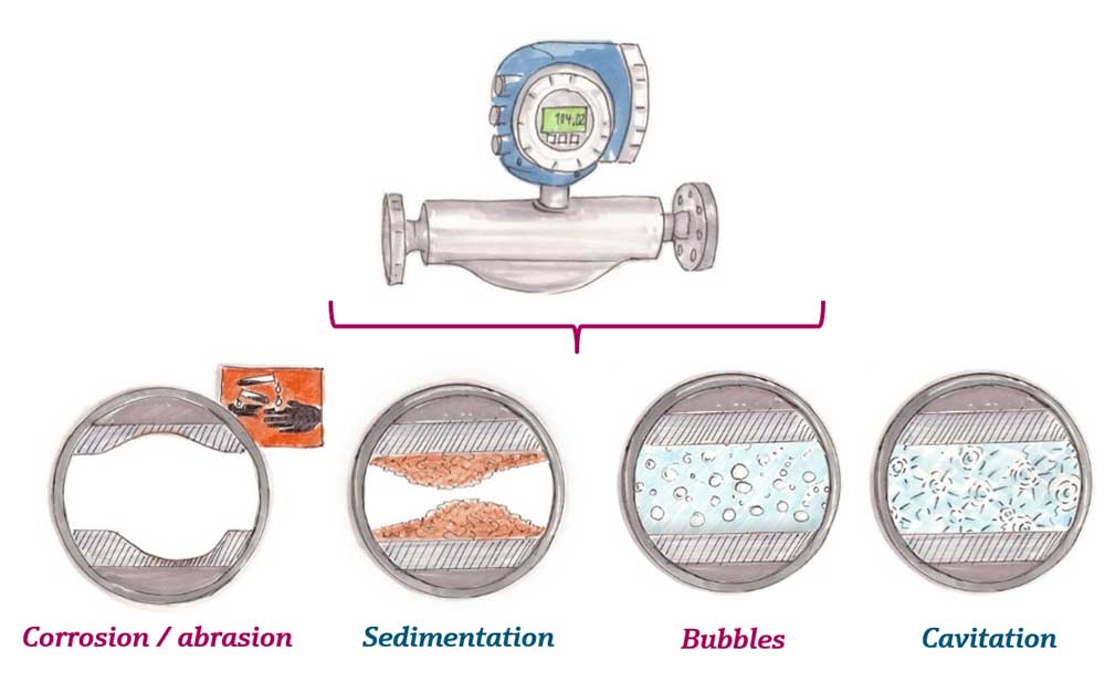

Left unmaintained, process-plant instrument performance can degrade over time due to adverse and accumulating process conditions, leading to measurement drift. All figures courtesy of Endress+Hauser

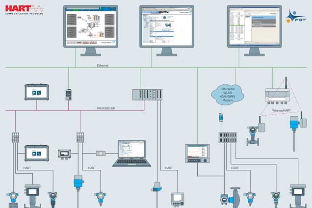

This diagram represents a common digital instrument architecture consisting of field devices, human machine interfaces (HMIs), and intermediary controllers and gateways. Several protocols are used, including HART, fieldbus, Ethernet, and WirelessHART.
Connectivity with digital protocols
Incorporating smart instrumentation into plants facilitates better process operation, management, and optimization by overcoming the challenges posed by analog-only instruments. Modern instruments employ digital communication protocols—such as WirelessHART, PROFINET, EtherNet/IP, and IO-Link—over advanced media, including wired Ethernet cables and wireless pathways, either in place of basic hardwired installation or superimposed on top of this analog infrastructure, increasing capabilities and value.
In applications where hardwiring the transmitters to a host system is convenient, including many facility retrofit projects, the two-way digital HART communication protocol is a good option for improving condition monitoring. This protocol uses traditional 4-20mA wired media, enabling two-way digital data exchange between smart instrumentation and calibration devices or host systems.
Smart instruments can also use fieldbus and Ethernet-based protocols, which offer all the digital capabilities of HART, although they typically operate at much higher speeds, using advanced communication media such as wired Ethernet or wireless connectivity.
When wired connections are impractical, smart instruments can use 2.4-GHz radio-wave protocols, such as WirelessHART. Many smart instruments now come with native wireless support, while others require add-on adapters. In both cases, wireless capabilities can be used to create mesh sensor networks throughout a plant. These types of connections are secure, with encrypted data transfer and password protection preventing unauthorized access. They provide communication redundancy by allowing alternative routing between devices should the shortest path become broken.

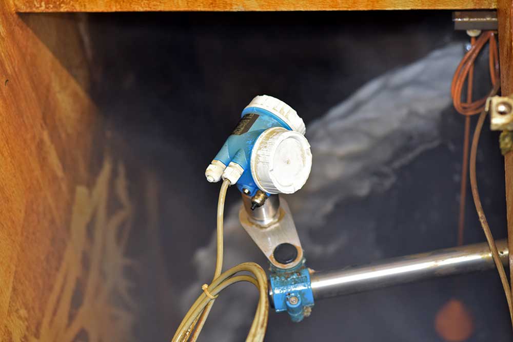

Endress+Hauser’s Micropilot FMR60B 80 GHz level instrument monitors centrate and foam levels simultaneously in a wastewater treatment facility’s sludge dewatering system. It also activates a defoaming agent when limits are breached.
One large wastewater treatment plant installed an Endress+Hauser, Greenwood, IN (us.endress.com), Micropilot FMR60B Smart 80 GHz radar level instrument to monitor centrate levels in its sludge dewatering system. Because the centrate produced in the dewatering process contains high concentrations of ammonium nitrate, it must be held in a retention tank and gradually released into the wastewater stream. Foam tends to form inside this tank, risking overflow if left unchecked, so careful monitoring is critical to detect foam and activate defoaming pumps, when needed.
Prior to installing the new instrument, the plant required two separate sensors to measure liquid and foam levels, neither of which were suitably accurate. The new sensor now handles both functions, reliably measuring liquid and foam levels simultaneously. It also directly regulates defoaming pumps with a continuous control signal, ensuring they operate at appropriate speeds for handling real-time foam levels.
This new setup provides the plant with better accuracy for improved efficiency, reduced maintenance needs, lower operating costs, and increased system availability.

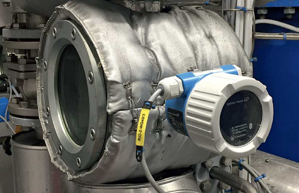

The Endress+Hauser Liquiphant FTL51B level switch verifies the refining system is free of oil and performs self-monitoring to detect problematic buildup on the sensor.
To mitigate these problems, the refinery installed Liquiphant FTL51B smart level switches in locations where buildup cannot be visually detected. These devices identify developing buildup, exhibited as a decrease in tuning fork vibrational frequency over time, making it possible to predict when maintenance will be required.
Plant personnel can leverage these predictions to proactively schedule maintenance in advance, reducing unplanned downtime. This saves the plant an estimated 1 hr. of maintenance time for every measuring point/week. Device status can be easily checked in an app with a Bluetooth connection with a standard smartphone or tablet.
