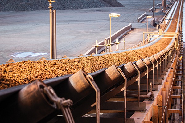

When a conveyor isn’t center loaded, the cargo weight pushes the belt toward the more lightly loaded side. Courtesy Martin Engineering
