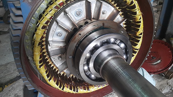

In this example, motor overloading resulted in rotor loading and harmonic content heat damage.
An overloaded motor that appears to operate properly is experiencing significant damage.
By Howard W Penrose, PhD, CMRP, CEM, MotorDoc LLC
This bearing, from overloaded air compressor, shows inner race melting from loss of clearance.
In the past four years we have experienced an increase in field troubleshooting calls involving catastrophic failures of specific types of equipment. When failed components, from melted bearings to damaged rotors and windings are reviewed and diagnosed as “the motor was overloaded,” the typical initial reaction, even from the equipment package companies, is that the control settings were not correct.
