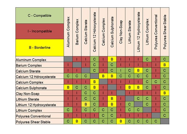

With lubricating greases, consider base-oil and additive compatibility along with thickener compatibility. Grease-thickener chemical composition ranges widely from simple lithium soaps to polyurea, clay, and complex soap thickeners of calcium and aluminum. Mixing greases of different thickener types can have disastrous consequences, from hardening of the grease in the bearing housing to extreme thinning, causing the grease to leak out through the shaft seal.
Fig. 1: Typical Grease Compatibility Chart. Compatibility charts should never be used to determine whether it is safe to mix two different greases.
Thickener incompatibility is a well-known phenomenon, giving rise to a number of so-called “compatibility charts” such as the one shown in Figure 1. Compatibility charts should never be used to determine whether it is safe to mix two different greases. Even two greases that are considered “compatible” in one chart may not necessarily be so when mixed under operating loads, temperatures, and ambient stressing conditions.
