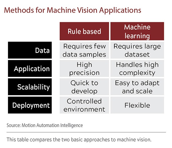

Rule-Based Algorithms
Rule-based machine-vision algorithms are quick to develop and deploy. They generally only require a small amount of data to create, often needing only a few samples of each form of inspection. This means less time is needed to gather data during development and, in a manufacturing environment, less product is wasted during data acquisition. Usually, algorithm building can happen in parallel with the building of the larger system.
If an engineer can easily predefine the characteristics, or rules, of the image inspection, it is best practice to begin a machine-vision application with a rule-based approach. Rule-based algorithms are highly accurate and repeatable, with most systems performing at or near 100% accuracy for whatever task. This makes it the ideal approach whenever high precision is necessary—such as metrology and gauging—as well as precision alignment tasks. However, its utility is by no means limited to these use cases.
Rule-based algorithms work best with strict and controlled part handling or advanced software fixturing techniques. Very slight changes in how an object looks in an image can dramatically hinder the performance of an algorithm. For this reason, an engineer
designing a machine-vision system using these algorithms must carefully consider how to present a part to a sensor for image acquisition to ensure the process is repeatably precise.
In addition, the objects that the system is attempting to detect must be consistent, with little acceptable variation. This can make it difficult to integrate these machine-vision system types into production environments where careful part handling (or fixturing) cannot be guaranteed or when the part has unpredictable variations.
Whether you use rule-based or machine-learning algorithms depends on what you’re inspecting and the available data.
Machine-Learning Algorithms
There are two distinct types of machine-learning algorithms: supervised and unsupervised. Each type seeks to create models that learn patterns from input data to predict outcomes. The difference is that supervised learning requires labeled data and unsupervised does not. For supervised models to train properly, the data requires human input during the acquisition and labeling process, which can be time consuming and laborious.
Machine-learning algorithms typically require larger datasets than a rule-based algorithm during development. The data must represent as many input varieties as possible in the production environment to be accurate and predictable. For a machine-vision inspection, this means collecting multiple samples of every form of inspection. The amount of data required varies with the chosen machine-learning method and the problem’s complexity.
Non-deep machine learning methods often require less data than deep learning methods but can be more limiting in application. Any machine-learning-based machine vision application will usually need to start with building a way to acquire and properly label data. The algorithm is built after the physical system has been set up and acquired data.
Machine-learning models thrive with applications where the data can greatly vary or may be subject to interpretation. A machine-vision system can use supervised machine-learning techniques to classify “good” or “bad” products that may otherwise require a trained human eye to sort. Human inspection is not ideal since opinions on tolerances will differ from one person to the next and may be inconsistent day to day. Machine learning removes this human error while still being able to classify data that traditional rule-based methods could not. A drawback of machine-learning algorithms, including deep learning, is that they are less accurate than conventional vision algorithms. Many applications struggle to perform at greater than 99% accuracy.
