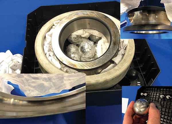

Fig. 1: Bearing has inner and outer race false brinelling and ball defect in Stage 1 failure.

In the first case study, a larger machine is operating at 686-kW load (input) and 610-kW load (shaft output at 96% efficiency) with a drive-end bearing with slight false brinnelling on the inner and outer race and poor lubrication, causing some damage to the ball (Figure 1). The total individual losses by defect (kilowatt spectra), as measured with electrical signature analysis, before replacing the bearing showed direct losses from these defects totaling 2.4 kW. This represents 0.4% of the total load, an impact on electric machine efficiency of 0.1%. At 6,000 hours of operation, average, and assuming static condition and load, this would represent 14,400 kWh and additional emissions of 10 metric tonnes of CO2 over the course of a year. This case represents the type of defect found in a Stage 1 bearing failure and does not include the misalignment and other defects associated with this application.
